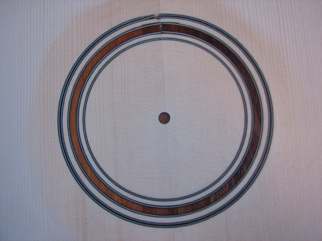

PostPosted: Thu Mar 16, 2006 8:42 am
Tracy,
I like the grain at a slight angle. I'm currently building a cedar/maple guitar with a Kingwood rosette and here's a pic to show the effect:
I don't think there are any big issues about stability whichever way you choose to orientate the grain.

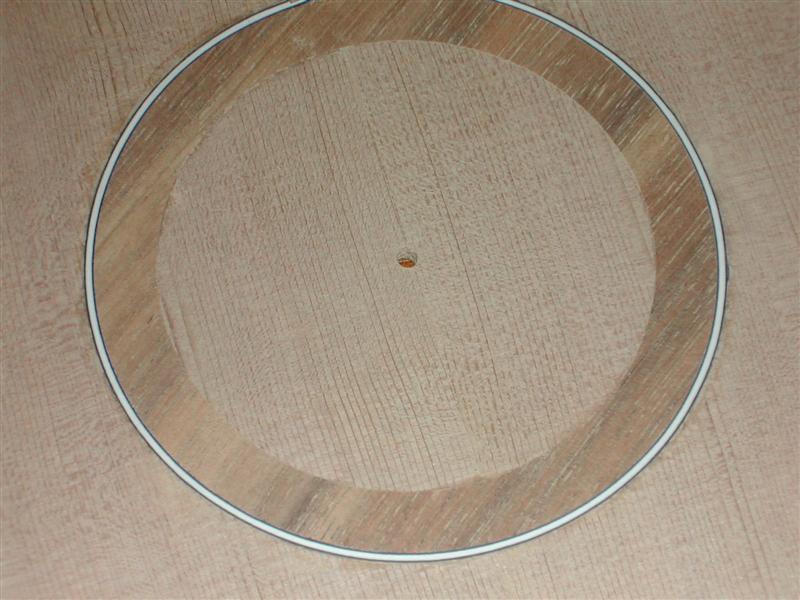

PostPosted: Thu Mar 16, 2006 1:51 pm
Tracy, here's one, koa on Adi. that's running with the grain.
PostPosted: Fri Mar 17, 2006 8:00 am
Posts: 688
Got the rosette in last night and decided on the grain running at 45 degrees. To me it looked more interesting. This picture is after scraping and sanding, but not completely done. Thanks again for all the great suggestions!
PostPosted: Fri Mar 17, 2006 9:08 am
Posts: 684
Location: Nashua, NH
Pretty darn tight there Tracy!
Nice job!
Wade
Wade
Nashua, NH
http://www.wadefx.com
PostPosted: Fri Mar 17, 2006 9:36 am
Whew hew hew hew hew, yep, not much room for a mosquito there!
PostPosted: Fri Mar 17, 2006 9:55 am
Posts: 688
Thanks Serge and Wade. It's amazing what a large hammer can do for you After I was done, I said "...like a glove". Nice and tight. Thanks for looking.
PostPosted: Fri Mar 17, 2006 2:46 pm
Tracy, if i succeed at this like you just did, my words will be : WHO'S YER DADDY!!!! Serge Poirier38793.9489699074
